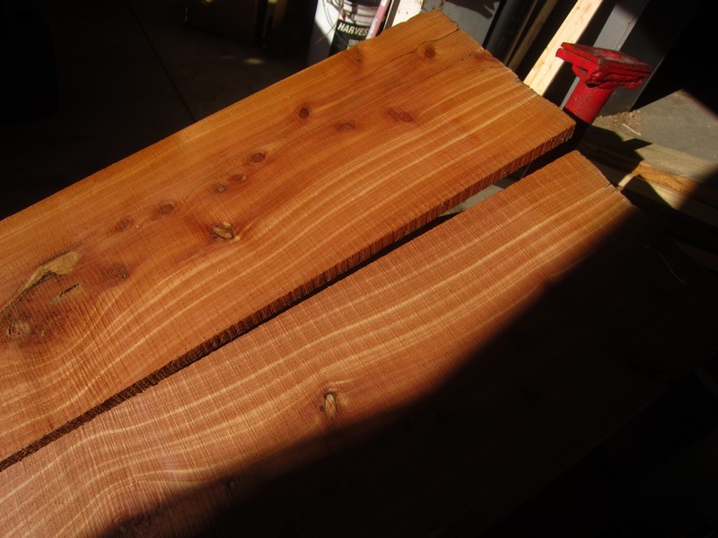

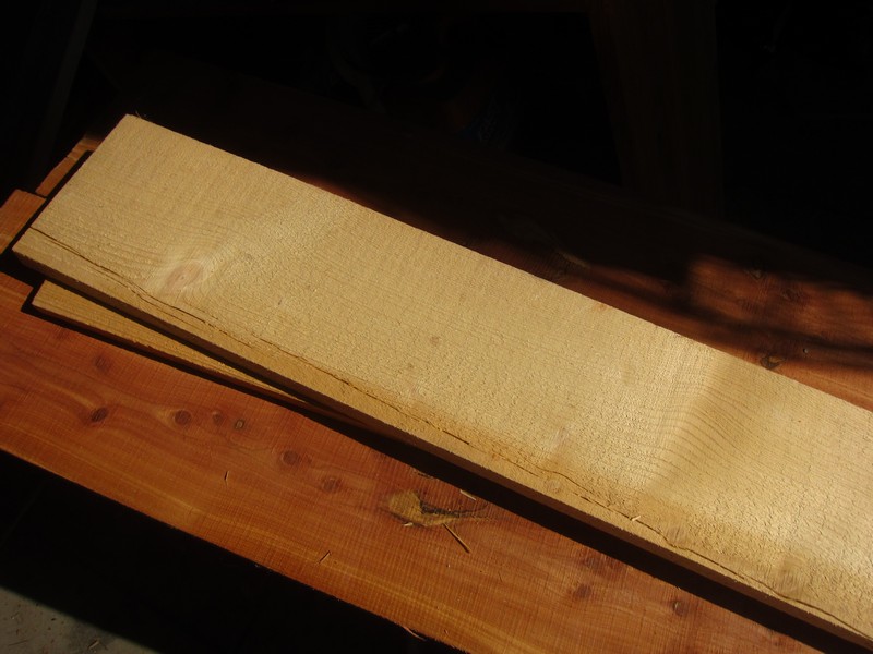

Well, I made a trip to my local sawyer this morning, and picked up some wood. I got some eastern red cedar, some catalpa, and some pine, all locally grown. I'm probably going to use the catalpa for the neck, cedar for the top, pine for braces, and walnut for the back and sides.
Some pics:

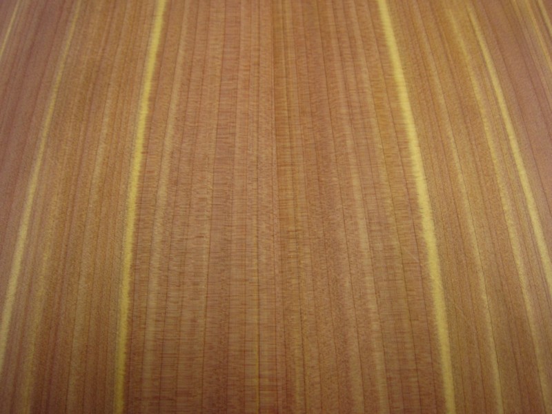

Cedar:
Pine:
Catalpa:

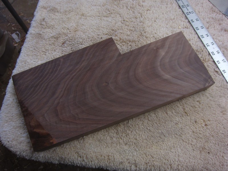

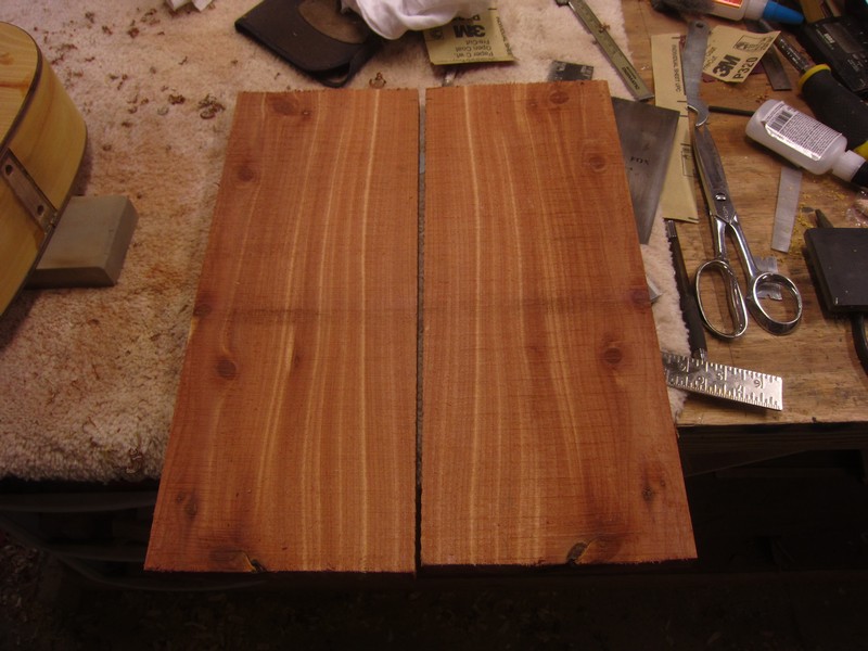

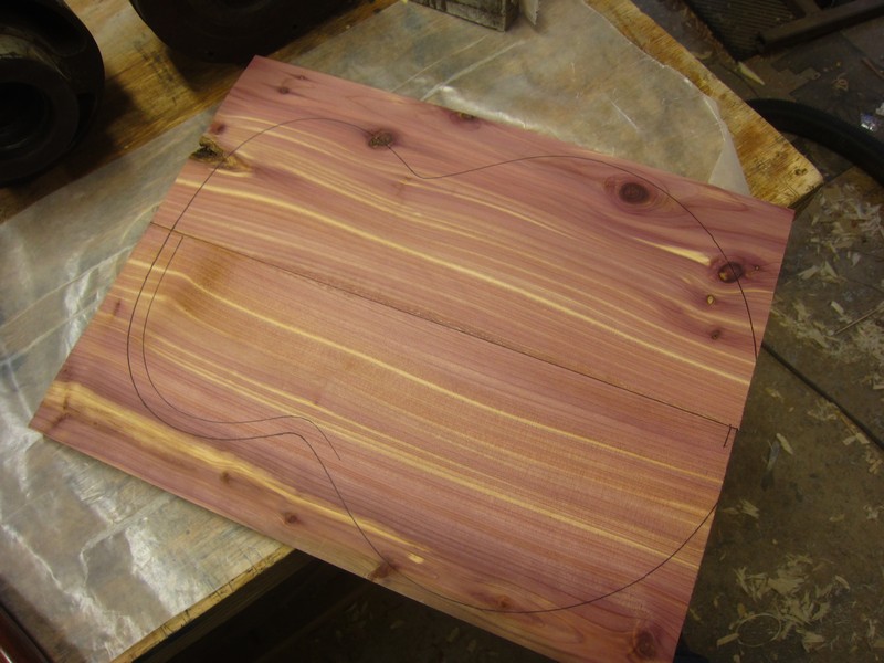

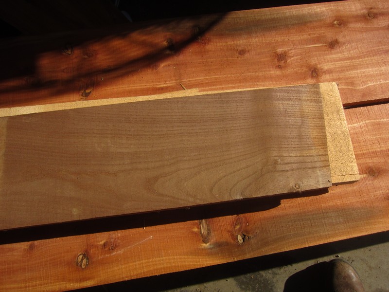

Walnut. I'm not sure I want to use this. It's almost perfectly flatsawn, and has a lot of runout.

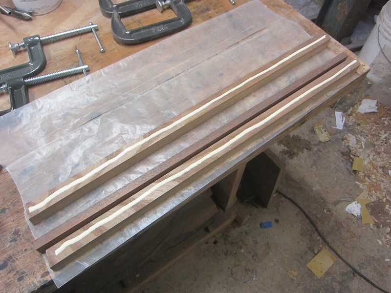

The pieces for the top:
After planing and jointing:
Gluing together:
More later.

Wow! That's some pretty Cedar!
I think I more or less agree with you on the Walnut... but I believe it would work just fine if you did decide to use it... You may end up slip-matching the back halves - that way you will keep the cup going the same direction.... rather than having an S-shaped back plate...

That is Beautifull cedar ! Man , I would love to have some of that . Where did u get it and do they ship ?

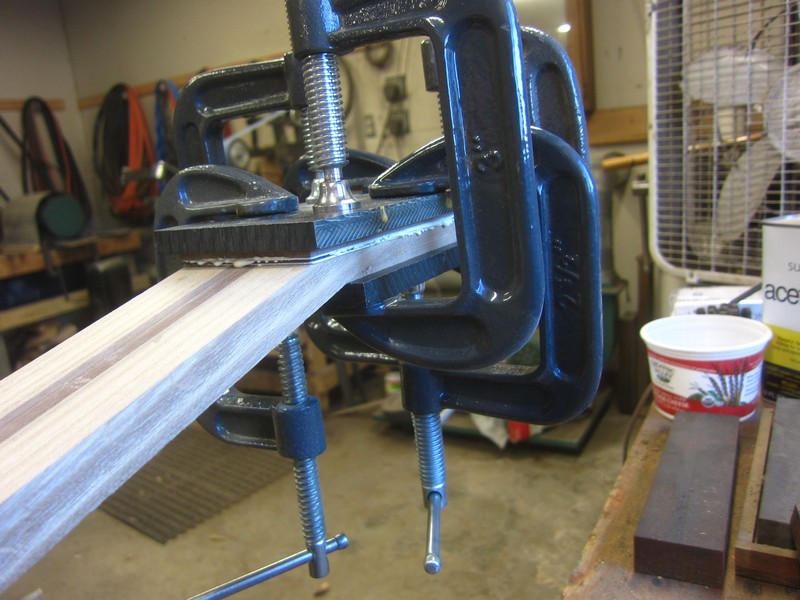

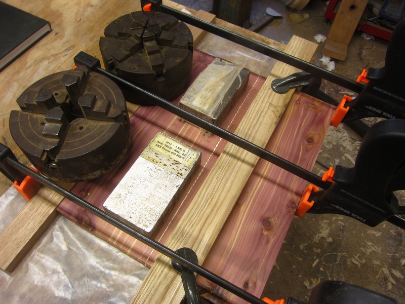

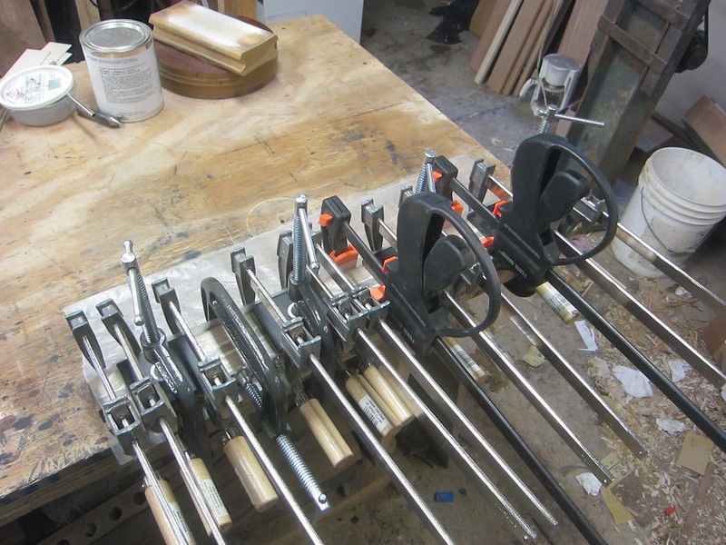

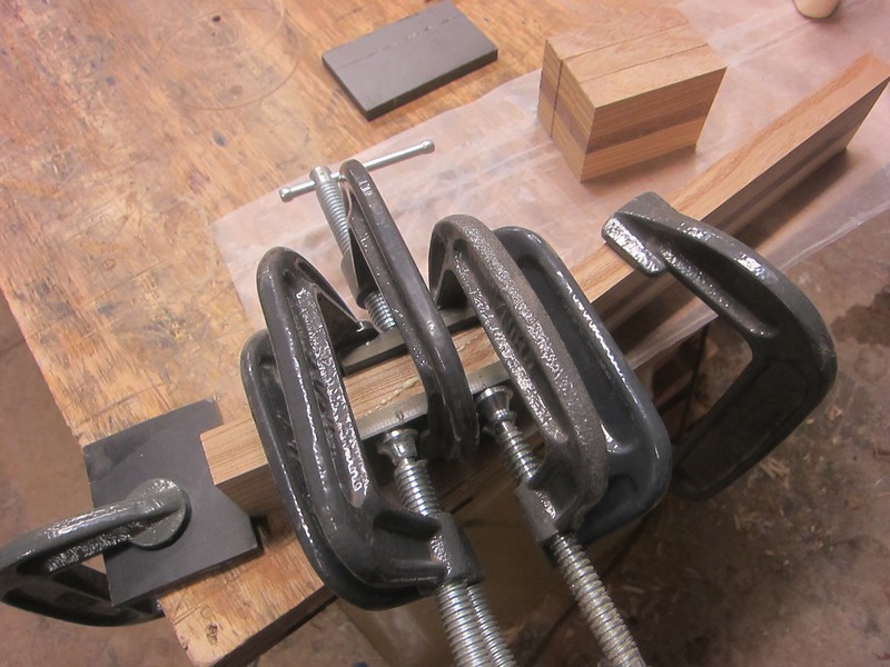

Well, I haven't really worked on this since last time I posted, except for today. I'm making a laminated neck. The catalpa I got is mostly flatsawn, so I'm gluing two pieces together, flipping them, to get a more or less quartersawn piece. Two pieces of catalpa wasn't quite wide enough, so I stuck a piece of black walnut in the middle:

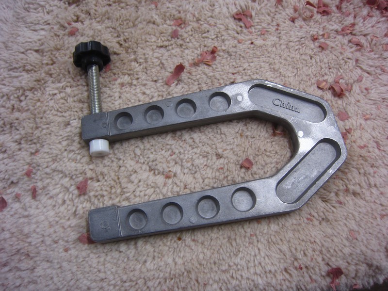

Enough clamps, do you think?

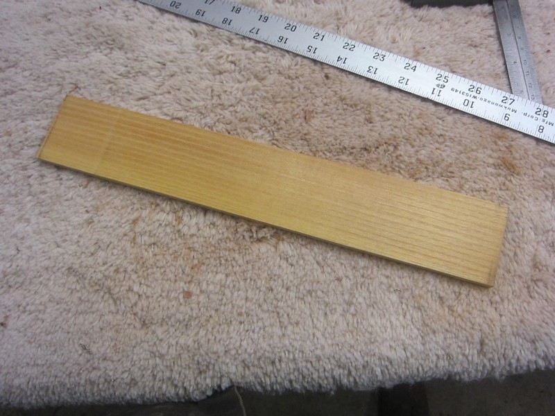

I also processed the fingerboard. It's osage orange. I'm not sure yet if I'm going to leave it this color or not.
This piece was straight grained enough that I was able to thickness it with my planer.

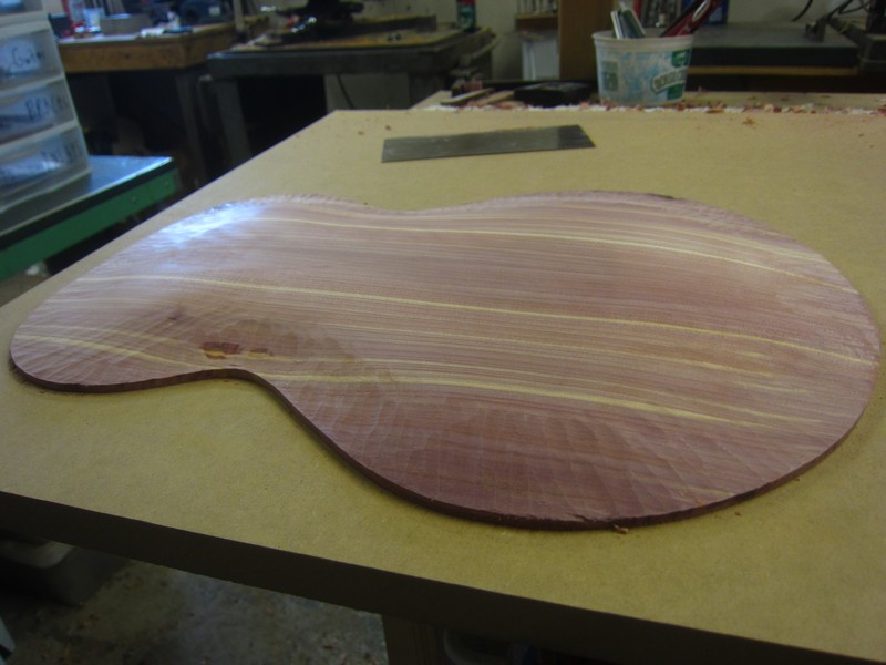

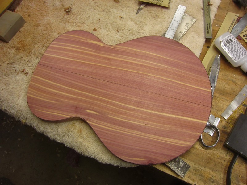

And here is the cedar top, joined and sawn to shape:
Wud, I don't think this guy ships. I might be able to though.

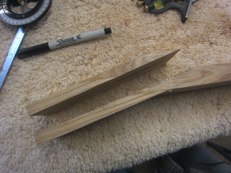

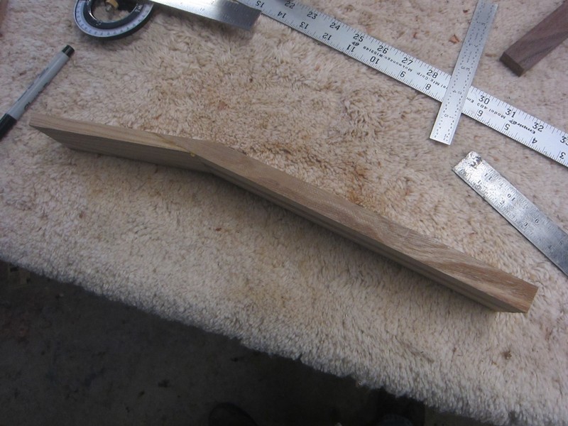

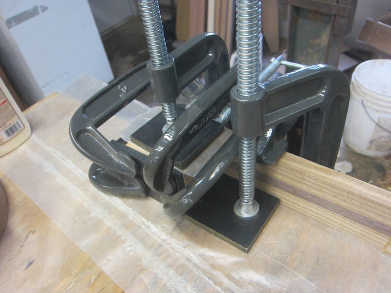

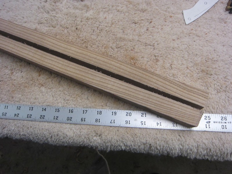

Ok, more pics. Gluing the headstock on:
Cutting it to final thickness:
Tapering the neck. It's 3/4" at the thick end, and 5/8" at the nut end.
Gluing the stacked heel:

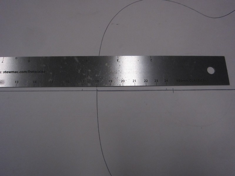

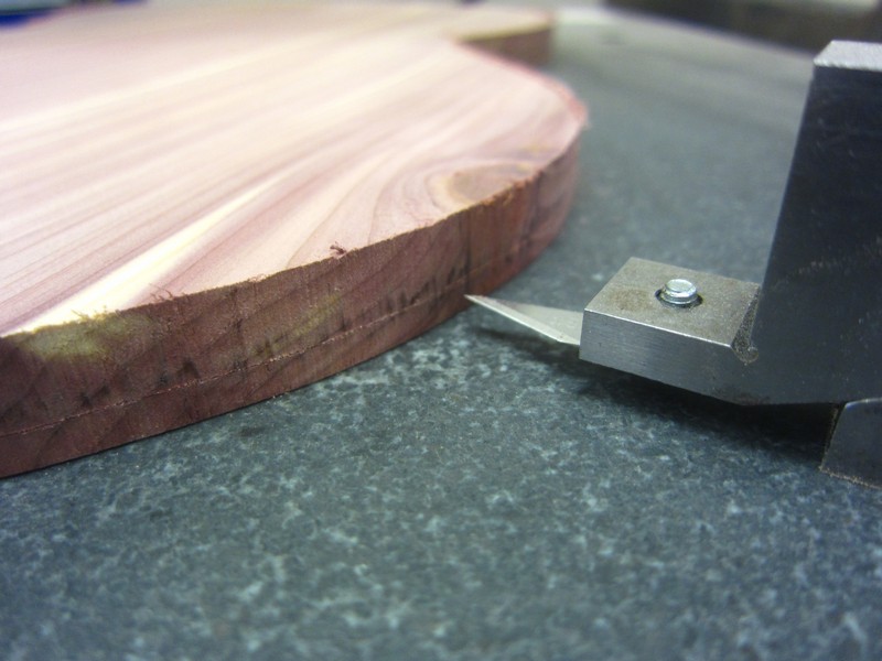

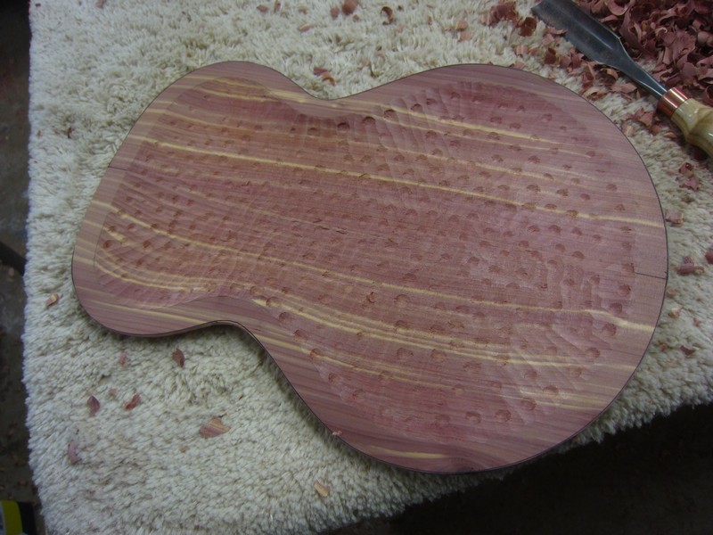

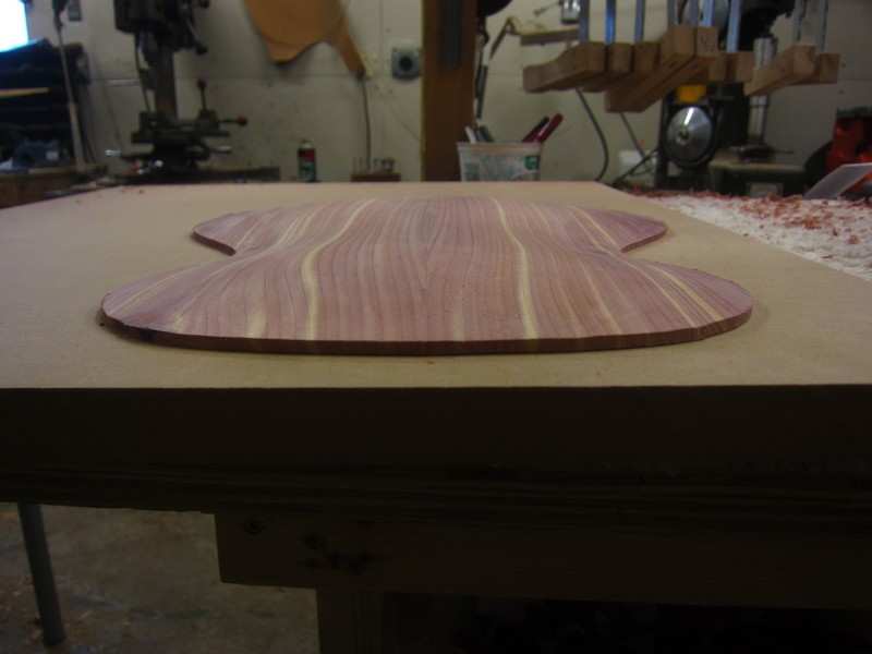

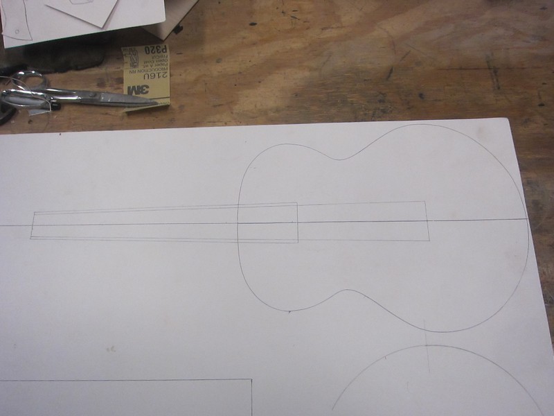

I used my Stew-mac scale ruler to draw everything in it's correct place. The 5th fret becomes the nut, and the 17th fret becomes the 12th. I goofed and made the neck too short, so this will probably be 13 frets to the body.
Marking the initial edge thickness:

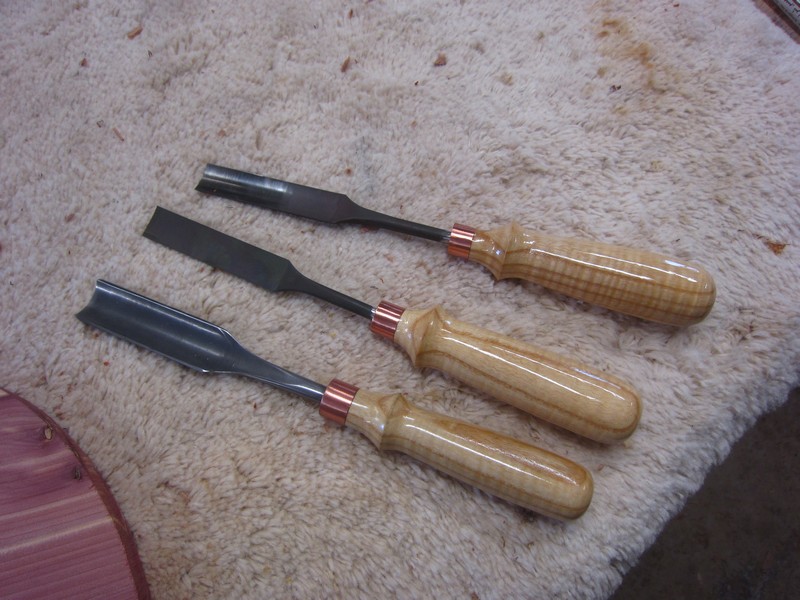

My gouges. I made them. The one on the left is damascus steel, the other two are A2.

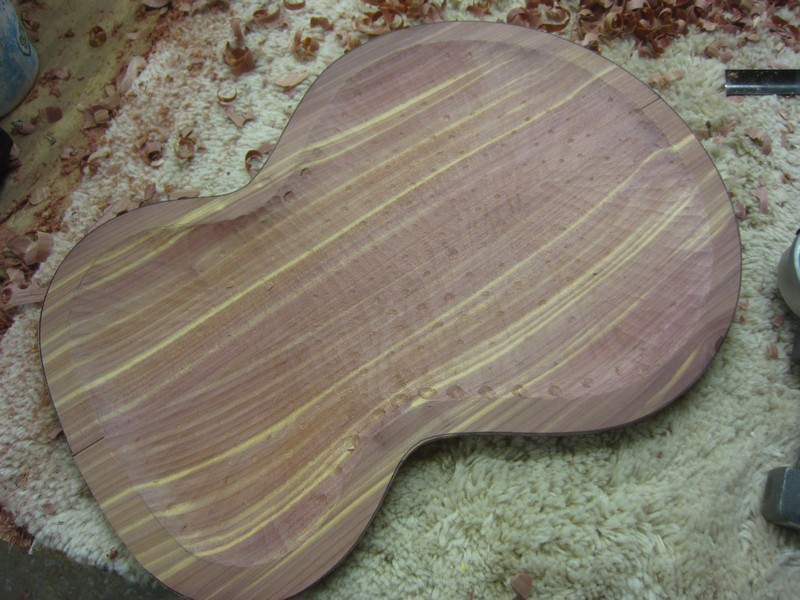

Carving the edges down to thickness:

crazicarl wrote:
How do you like gouging the top by hand? I've seen guys do it on the drill press and on a CNC, but not too many have I seen with gouges. I bet if you're good enough with the gouges (which it looks like you are) you can probably carve by hand quicker than it takes to do the setup for just one piece.
It's actually kind of fun, except for the knots... This cedar has a much smoother texture than the spruce and cedar violing tops that I've started, so it's very nice. I've never finished an archtopped instrument, so I'm learning as I go. But I do have a good violing making book, which helps a lot.
I will be using the drill press when I do the inside.

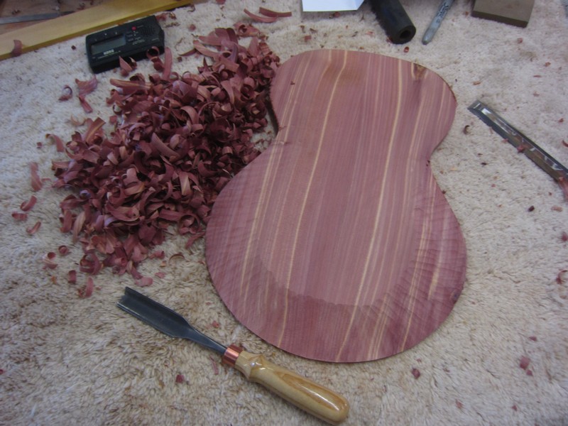

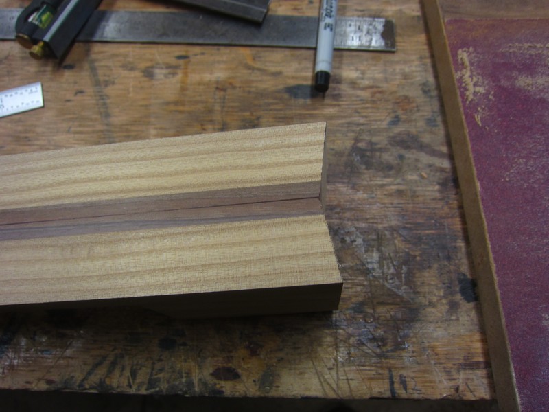

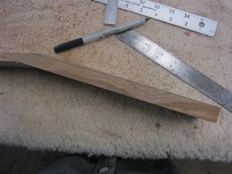

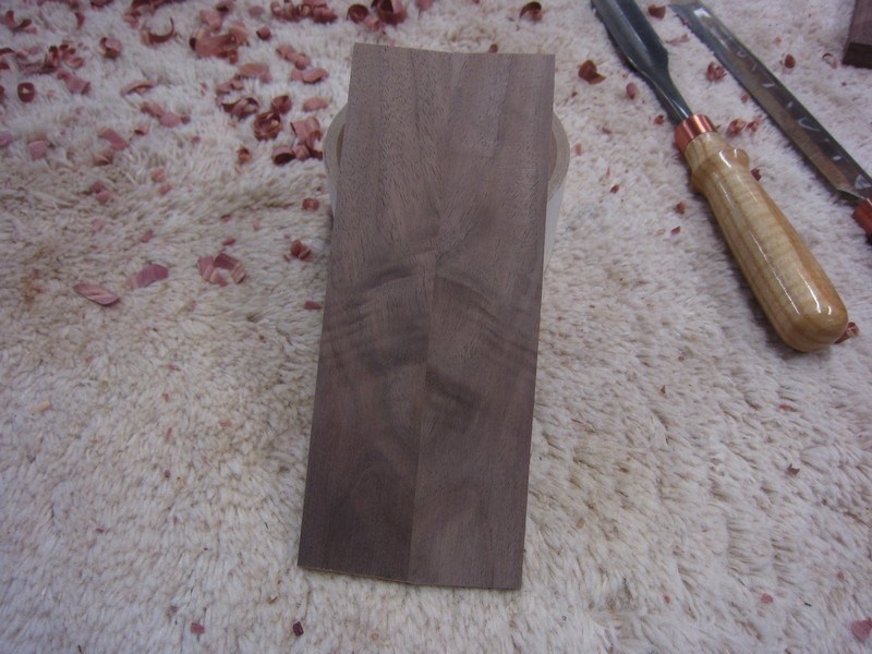

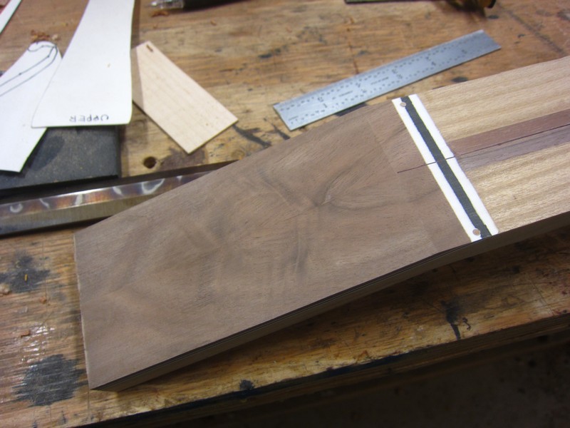

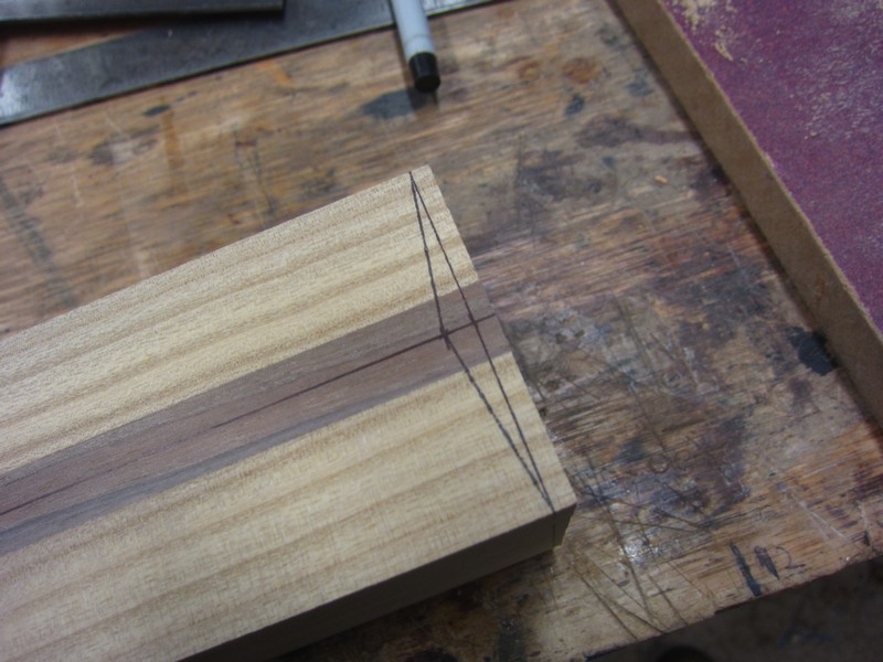

Ok, yesterday I made the headstock veneer and glued it on. I'm using black walnut, bookmatched, then some fairly thick layers of black and white fiber.
Today I cut heel to length, angling the cuts. I guess I forgot to mention that this will be a bolt on neck.
I've also been working more on the top. I finished with the gouges, and started using scrapers. Worked up a pretty good sweat...
Should finish the outside of the top today.

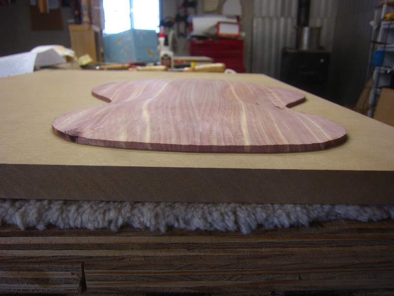

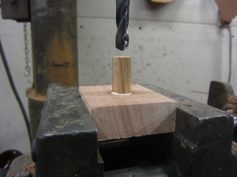

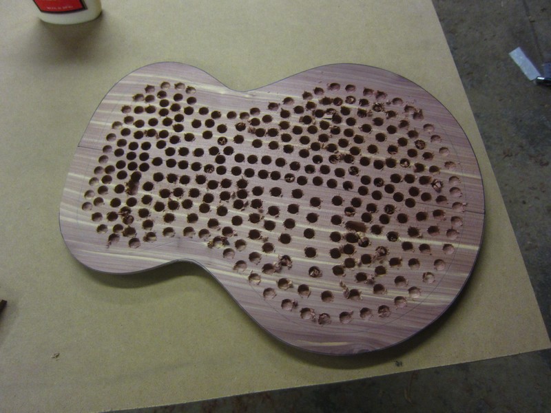

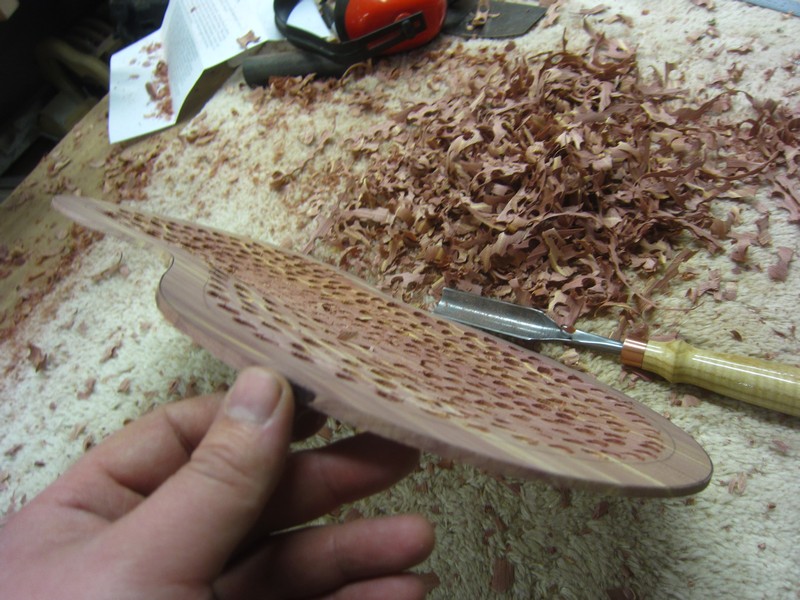

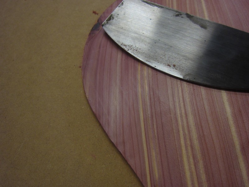

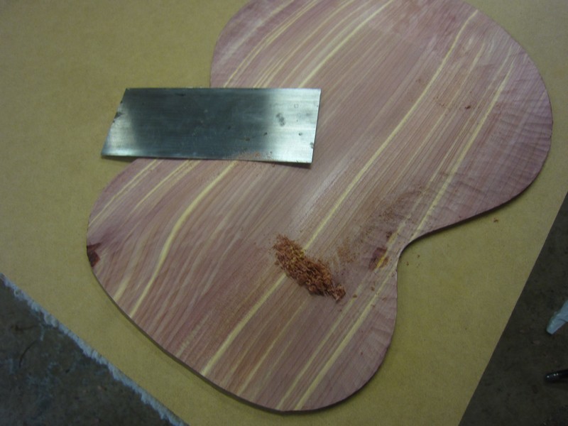

This morning I finished scraping the outside of the top:
I made this contraption for drilling out the back. I think it was set at about 5/32".
Drilled:
Starting to remove the excess:

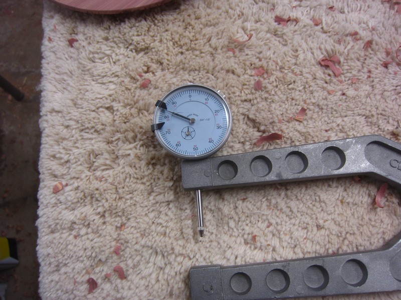

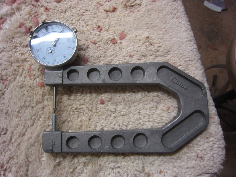

Just some dimples left. Next thing is to buy or make a thickness gauge.

Thanks, and you're welcome. I'm sure there's going to be a lot to be learned from all the other threads, and I'm looking forward to that.
I've been putting off buying a thickness caliper, because they are so expensive. The other day I noticed that Menards sells dial gauges for $30, so I decided to make my own.
I used a deep C-clamp for the frame. Just take the screw out, and drill it to fit the gauge. Then drill another hole on the bottom for a post. I just used super glue to hold the pieces together. Some pics:
So I saved about $90. bliss
Here I've switched to a flatter gouge and removed almost all the way to the bottom of the dimples. I'll use scrapers for the rest.
According to my new gauge, the top is about .140" thick. Anybody have any idea how thin I should go?
Regards,
Phillip Patton
http://www.pattonblades.com
The bitterness of poor quality lingers long after the sweetness of low price has faded.
https://hoosierbladesmith.wordpress.com
Phil... you may have just blew it, pre-emptively. The general rule, for mandos at least, on the recurve is that it is 60% of the thickest part of the top... so your recurve should be around .084" which is just over 1/16".
I just carved some mando tops, of extra stiff Sitka, down to .2" at the bridge location and .12" at the recurve. You are using cedar... which is less stiff than spruce... and... using aromatic red cedar... which is less stiff than western red cedar.
On the other hand... if you find some tried and true info that still has you on the right track, I can't wait to see/hear it fully loaded.
Chris Oliver
Infinity Luthiers
...in the shop.
live every minute...
Are mandolins braced? I was planning on using an X bracing scheme on this like many archtop guitars have. Also, this is a uke, which only has 4 strings, so I would expect the tension to be quite a bit less than a mandolin.
Thanks for your input though. I've never done anything like this before, and I don't have any books on archtops (other than violins) so the probability of messing up is pretty good. My gut feeling though, is that it's ok.
Regards,
Phillip Patton

Maybe I should just consider this a practice top, since I forgot to leave a flat area for the head block, besides (maybe) making it too thin.
Regards,
The neck and tail block areas appear fine. You square out an area at the neck block and glue in some cedar if needed. Also.. don't carve the recurve until you have strings on it. That way you can tune it in to the way you want it to sound. Like you wrote, only 4 strings... not too much down force. Plus, the knowledge that it could implode at any time is kind of exciting. gaah

Chris Oliver wrote:
... don't carve the recurve until you have strings on it. That way you can tune it in to the way you want it to sound. Like you wrote, only 4 strings... not too much down force. Plus, the knowledge that it could implode at any time is kind of exciting. gaah
I'm guessing you do that from the outside, before finishing, yes?
I've been researching online some, and I think I want to go with parallel bracing for this one.
